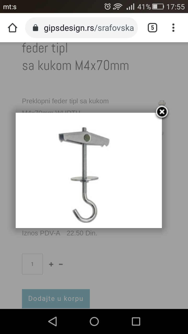

A, tipl
mrkip
mrkip's picture
Registrovan dana: 21/01/2014
A, tipl metalni
https://gipsdesign.rs/srafovska-roba/preklopni-feder-tipl-sa-kukom-m4x70...
