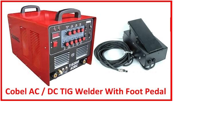

Da li je neko video ovaj aparat ili mozda radio s njim
Demian
Demian's picture
Registrovan dana: 23/07/2009
This excellent package includes both the Cobel AC / DC TIG Welder and a foot pedal that is designed especially for the Cobel TIG Welder.
There are TIG welders and there are inverter welders and there there is the Cobel 200AMP pulsed inverter TIG AC/DC welder!
The newly developed Cobel TIG200P AC/DC welder can weld stainless steel, alloy steel, carbon steel and other non-ferrous metals with the DC function and aluminum and alloy aluminium with the AC function.
The power exchange rate of this welding equipment is over 85% and is energy saving. With the exclusive HF Inverter technology this welder is smaller in size, lighter in weight, has a higher power exchange rate and is more energy efficient than other similar welders in the market.
The outstanding feature of this welder is the application of twice square eaves interveter technology, which allows pure square wave output.
This auction includes a dedicated foot pedal, making it simply an outstanding welder
Model TIG200P AC/DC
Power voltage 220V
Input frequency 50/60 Hz
Rated input current 20A
Power capacitance 4.5 KVA
Rated output current 200A
Range of output current 5-200A
Arc force 0-100A
No-load voltage 56V
Working voltage 18V
Pre-flow 0-2S
AC output frequency 60Hz
Clean width 20-80%
Slope-down time 0-10S
Post-flow time 0-10S
Base current 10-90%
Pulse frequency 0.5-300Hz
Pulse duty cycle 10-90%
Arc leading HF VIBRATION
Efficiency 85%
Load duty cycle 200A-60%
Power factor 0.93
Weight 20KG
Dimensions 493 x 330 x 320 mm
Max welding thickness 10mm

Bice da je u pitanju genericki kineski prozivod . Jel sto bi trebalo da dosta govori o njemu i o kvalitetu istog no ne mora da znaci da je bas smece . Cena od oko 300 -ak E govori da spada u nizu klasu . Pogotovo sto u tu cenu ulazi i pedala i komplet za tig . E sad zavisi za koje namene bi se koristio ne verujem da moze da zadovolji od neke srednje upotrebe u manjoj radionici .
Inace su i na inostranim zavarivackim forumima misljenja vrlo podeljena ali ga svi max ocenjuju kao SSM tj hobyy masinu

Uz malo "istrage " i pojavi se ovaj aparat . Definitivno ga rade kinezi i to bar 6-7 firmi tolko sam im'o zivaca da ispratim :tup :tup
Evo i crno na belo KINEZI
A sad sve ostalo je na onom ko' oce da ga kupi :hh :hh

Imam ponudu za 860 a sluzio bi mi za neke tanje stvari u Al .Cenovno odgovara al ne znam moze li sve to sto pise.Miller mi je dao ponudu za nesto slicno oko 4000.S druge srane Gorenje?Radio sam s Gorenjem i nista posebno nekako ko kinezi al "ZNAS TO JE GORENJE"Jedan moj prijatelj mi kaze da je ova masina iskopirana od gorepomenute i radi mu evo druga godina u komercijalne svrhe.Ja ne hvalim ovaj aparat, samo pitam da li je neko radio s njim?

Vidi ako sam te dobro razumeo cena 860 E
To je ne previse skupo nego je to strasno i ne vredi te pare sigurno . Za te pare mozes naci Linkolna il nesto u toj klasi ( tig bez AL )
I ono sto je uvek problem sa kinezima su garancija i rezervni delovi
Ja ti kaz'o a i ti kako oces .
I da dodam jos jednu stvar kod kineske robe se uglavnom ispostavi da su karakteristike i performanse manje bar za 50 % od deklarisanih

Evo sad u online komunikaciji sa jednim kolegom iz Londona , on mi kaze da taj Cobel bas isti kosta oko 270 funti i to u radnji .
E sad za Linkolna sta da ti kazem delovi se kupuju u Bogradu i svega ima .
A usput u vezi Linkolna mogu da kazem da je jedino on radio na -49 stepeni
E sad sta reci ovo u vezi iskustva mozda sam i ja radio sa tim istim aparatom al nije bio pod imenom "Cobel " . Inace mi samo kuciste lici na jedan aparat s kojim sam radio /probao a ime mu je bilo Krant ako se dobro secam . I aparat je vrlo los . Ali opet je odluka na tebi .
Ne znam cime se tacno bavis , ali ako se bavis zavarivanjem profesionalno onda bi ti ipak trebao neki profi aparat a ne kineska igracka
A opet kazem na dosta zavarivackih foruma sam clan i svi imaju samo losa iskustva sa ovim " Cobelom " u stvari sa tim modelom bez obzira na robnu marku -nalepnicu na njemu

Jedan majstor mi je pre nekih 6-7 meseci doneo nov takav aparat ali pod imenom "Greenbird" da bih ga malo obucio da radi na njemu. Aparat je kineski definitivno i imao je vrlo oskudno uputstvo na engleskom. Ko zna kako je dosao u Srbiju jer je bio nov ali nije imao ni racun ni garanciju niti postoji ovlasceni servis
Ono sto mi je odmah zasmetalo je da ima displej, ali je radio samo pri REL postupku. Kada se prekidac prebacio na TIG AC, na displeju se amperaza nije menjala. Da bi se na displeju ocitala amperaza pri TIG postupku bilo je potrebno prebaciti na REL, podesiti amperazu, pa tek onda prebaciti prekidac na AC TIG. Aparat ima los balans AC struje (ali ga ima), i zanimljivo da je inverzno podesen u odnosu na podesavanja kod evropskih aparata. Ne secam se onog, ali ovaj nema podesavanje AC frekvencije, vec mu je fixirana na 60 Hz, sto ga odmah svrstava u najnizu mogucu klasu AC TIG aparata.
Sama sekvenca je najprostija moguca.
Sto se ostalog tice, radio je OK, i majstor je kasnije sa tim aparatom radio cak i cevcice klima uredjaja na kolima i za svoje potrebe je bio zadovoljan.
Ako smatras TIG postupak krunom zavarivanja, onda kupi i TIG aparat barem iz srednje klase, mani se ovoga.

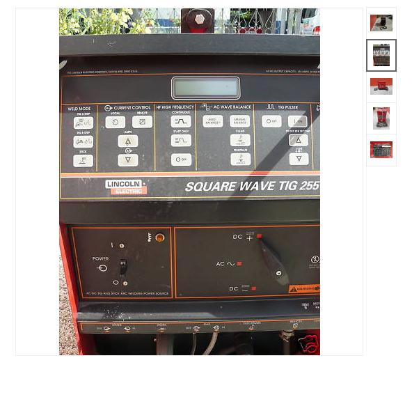

Tenzore jel po volji ovaj aparat trenutno sam u teskim pregovorima
evo i neki forum gde se mnogo bolje vidi
http://www.pirate4x4.com/forum/showthread.php?t=784894

Koliko vidim, to je ko u onom vicu, taj aparat je samo za odlikaše. Laughing out loud
A o ceni bolje da i ne pitam. :nes

Nije strasno izaslo bi malo vise od 1000 zavisi od prevoza,najveci problem je upravo to jer je aparat tezak 137 kg-tesko za utovar i transport,o nekom spediteru ni govora.To sto je tezak znaci da je kvalitetnu izradu starog tipa
nema mosfetova i chopera cist bakar!
Svidja mi se to sto aparat sam mesa gasove kad je potrebna mesavina npr hellijum.E sad pitanje nije li malo previse za moje potrebe?
Sun, 13/12/2009 - 22:18
Re: Da li je neko video ovaj aparat ili mozda radio s njim
Pa sve zavisi za šta ćeš da ga koristiš.Ako će ti biti izvor prihoda na neki način, bilo kao osnovna ili dopunska varijanta, onda je investicija ok, a ako ti služi samo za hoby, čitaj malo za zabavu, e onda je tu nemoguće dati savet.Neko potroši toliko para da ode na more 10 dana i više nema ništa, a ovako tih 1000 uloženih evropskih novčanica ostaje negde u radionici i ako ništa drugo aparat se opet može prodati jednog dana za neku sumu.Prema tome novac neće propasti sigurno.
Što se transporta tiče može se natovariti u auto prikolicu, dobro vezati i to je to.Ili da se transportuje u nekom kombiju.Za utovar se može koristiti strma ravan.Dve kraće fosne i dva snažna momka i aparat je utovaren.
